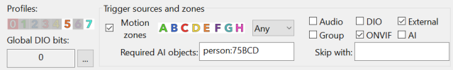

- trig_source — looks like a wider bitmask (I see 132, 16514, 16516, 16518, 16522; bit 14 = 16384 seems to correlate with
AI confirmation). I haven't worked out the full bit layout.
