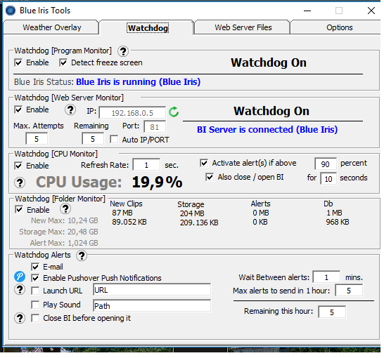

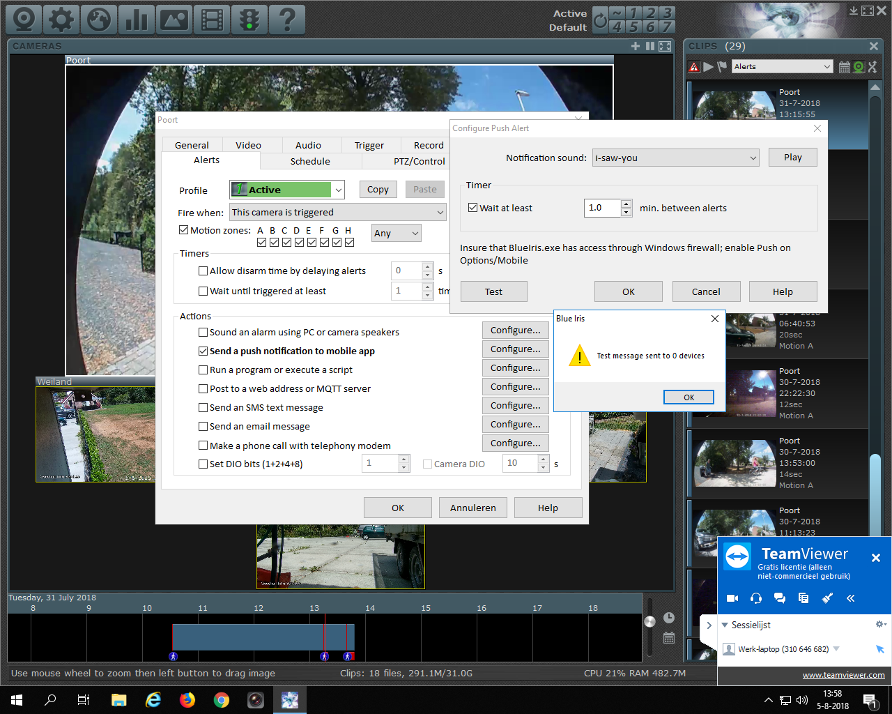

Ok tnx for that info.
So I need Alexa to get push notification up and running?
What I want:
On motion detection a push message to my phone.
What I saw in the setup that adding phones is done through Alexa
added two screenshots of my setup.
Push notifications sent to a phone based on motion is accomplished by setting it all up in Blue Iris.....period.
No Alexa or Bitools required.
It's all in the help file. Find an online translator to run the help file through.
