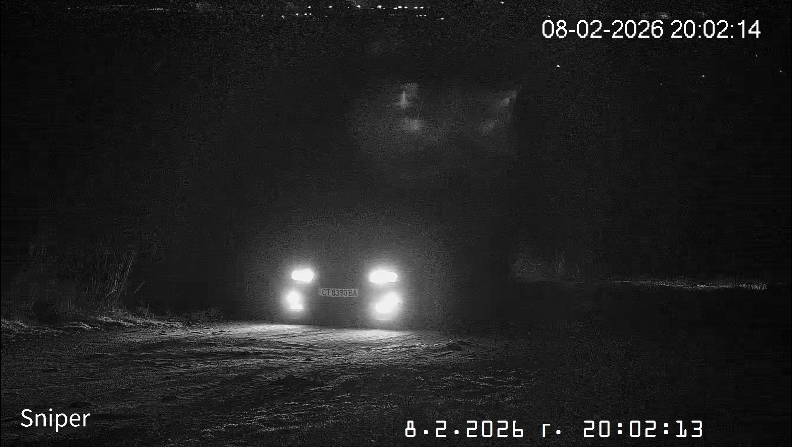

I have a EmpireTech IPC-B54PRO-Z4E that I configured as LPR camera. It works fine as multi purpose cam during the day, however at night it is with 1ms shutter and it shows almost pitch black unless a vehicle with reflective plate/headlights comes in which case I get a perfect shot of the license plate. That's great but I want ot use it for something more... Is it possible to match this with AI detection so that for example tha camera runs on the "Self-adaptive" image setting and then switches to "night" profile if it detects a vehicle? Cars around me drive very slowly, so there should be sufficient time to switch and still get a shot of the license plate, however I am not sure how to implement this (if it is possible).
Currently I have the camera set to use IVS and that's all that triggers it. Once it is triggered - it also uses the built-in AI (BI >6) to analyze the images so that it can tag it for human/animal/vehicle. The AI is just for tag - it does not cancel or confirm alerts - alerts are only triggered by IVS. So is there anyway to use self-adaptive and switch to Night mode for like 5-10 seconds after "vehicle" alert, and then switch back to Self-Adaptive until next time?
