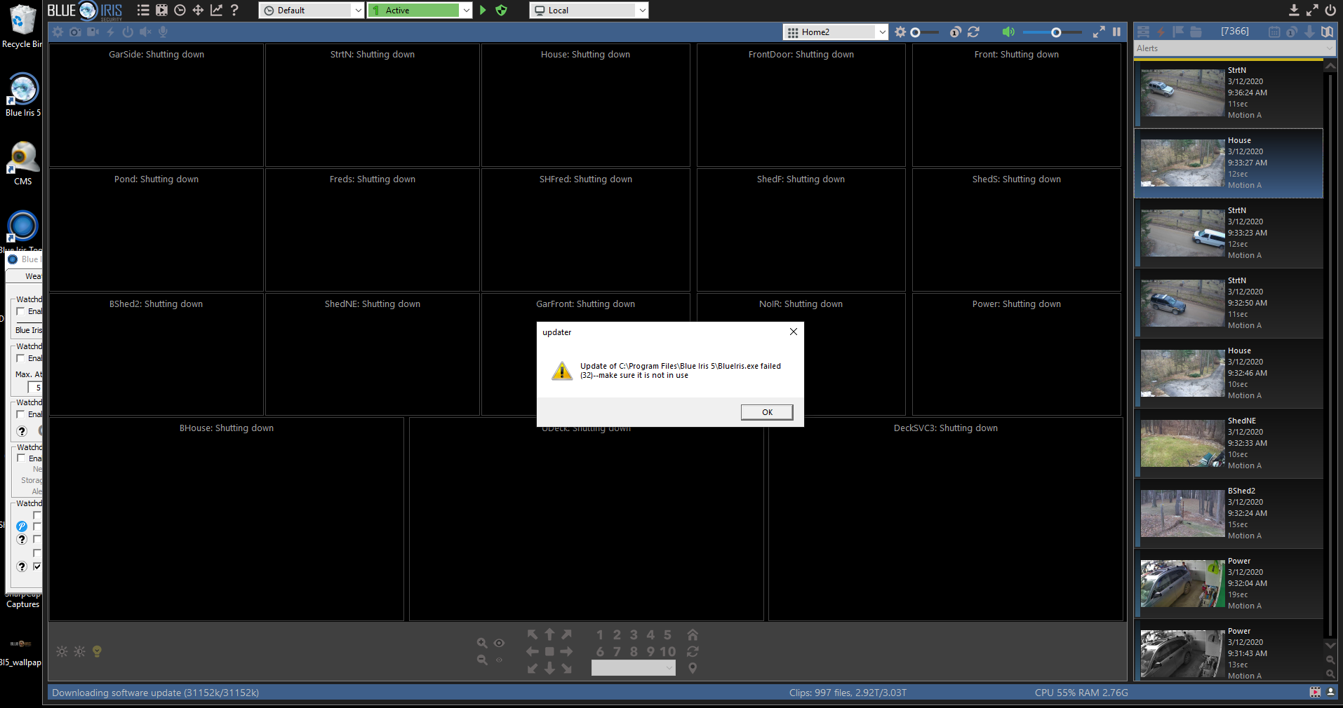

I have been using BI Tool for the past few months, and all has been going well. With past 3-4 BI updates though, I noticed that updates won't work since BI will get stuck when the updater tries to close BI.
Specifically I have to quit Blue Iris Tool and Kill BI, reopen BI (without BI tools open) then run update for the update to work.

Logs wont say much. When you are available shoot me a PM so I can remote in. Otherwise I have no way of figuring this out.

I'm updating as I write this. I've been completely shutting down BIT first (it still takes me 2-4 times to update BI). This time, I just tried merely disabling Watchdog. Same same. I have to end the BI task in Task Manager (see attached pic as to the error message), restart BI, and update again. I can still count on it taking 2-4 times (today was 2). So... not a BIT issue...
