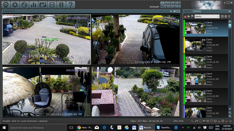

Hi as the title suggests
I have included a screenshot of the overlays.
Camera 1 top left.
attachment.php
attachment.php
attachment.php
I am happy with the one bottom centre but in middle of screen the green temperature one will not delete.
I have looked at the help file and the hand gesture will not come up for me to delete it.
The other Macro I created (centre bottom) can be moved, coloured etc.

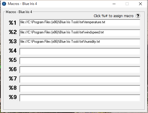

When I look in Blue Iris Macros
I have %1 %2 %3 showing only and also in tools I only have the 3 marked.

Currently I have deleted all Macros and the green and white ovelays are gone, but If I try to add for example Temp to %1 and follow the process the green temp shows up in middle of screen again (can not be moved etc) and also the one in middle bottom which I can still move, colour etc
You have to move the Macro in Blue Iris itself, not in Blue Iris Tools. Check out the FAQ thread, it has some pictures there :)
That is the strange thing Mike. I removed the Macro in Blue Iris but it continues to show up when I add the Tools Macro.
What I mean is, I have deleted the Macros from Blue Iris completely but it still shows up when I redo thee Macros in tools.

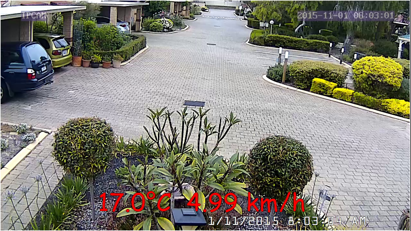

Screenshot 2015-11-01 08.03.05.png I ended up with this solution, I left %1 blank and just did Macros %2 %3 Happy with result No amount of deleting, moving etc in Blue Iris would get rid of the Green Temperature Overlay without me leaving %1 blank.
I cleared and double cleared the overlays in Blue Iris Video and in the Macros section, yet the green Temperature over lay kept appearing, so my solution finally got a result.
View attachment 6031 I ended up with this solution, I left %1 blank and just did Macros %2 %3 Happy with result No amount of deleting, moving etc in Blue Iris would get rid of the Green Temperature Overlay without me leaving %1 blank.

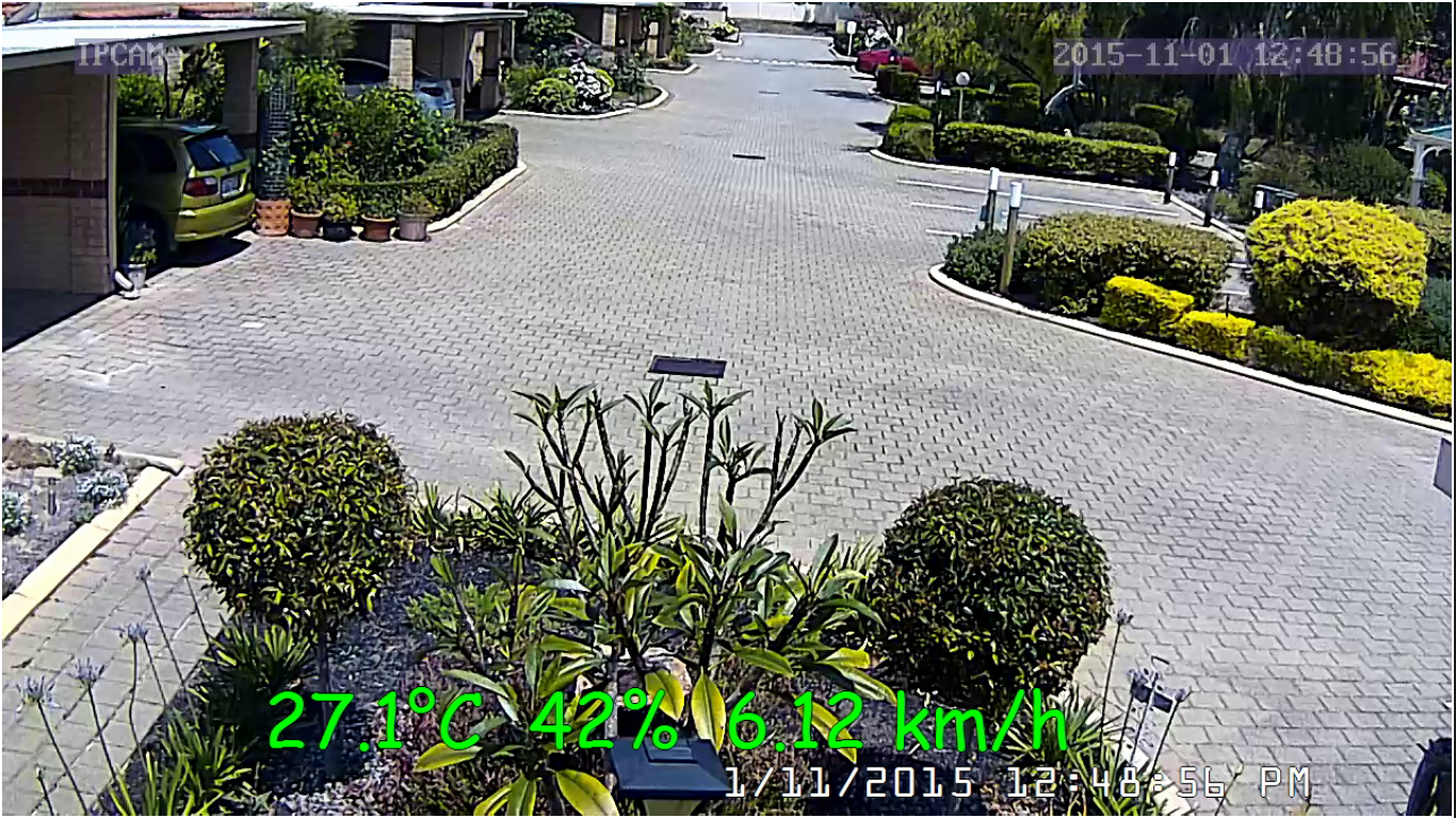

Here is my current overlay, very happy. I am just continually astounded by you guys with Blue Iris/Blue Iris Tools. I cannot give you enough accolades.:redface-new:
As usual, U guys were right, I deleted the camera and reinstalled and that ghost green temperature overlay was gone for good.
