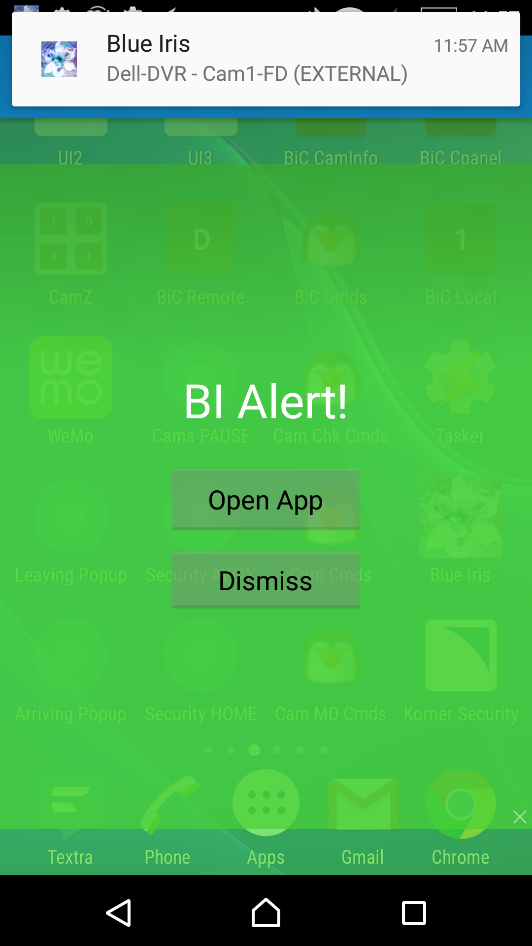

Here's a DEMO... the screenshot below shows the result of AutoNotificaton intercepting an incoming Blue Iris App notification on my device. At the top of the screen you see the BI App's originating heads-up notification. Under it you see Tasker's response -- a custom Tasker 'Scene' (green with action buttons).
In this demo, I've made the Tasker 'Scene' "persistent". That is, it remains visible even after the BI App's heads-up notification has gone away. This ensures I don't overlook the notification. In fact, it is still there, big and bold, even if the phone's display has turned itself off and I've just turned it back on. (The BI App's original notification remains in the phone's notification drawer).
Of course, the actions can be anything you want, not just showing a scene. Like everything in Tasker, you must be prepared for a learning curve. To help get you started I've attached a zip file containing three xml files used to create the interception demo above. It contains a 'Profile' (*.prf.xml), a 'Task' (*.tsk.xml), and a 'Scene' (*.scn.xml).

After you have installed the AutoNotificaton plugin, you need to import these transferred files into Tasker. First long-press on the 'Profiles' tab to expose the Import menu (see image), then navigate to the 'source' folder to select imported file. Then repeat 2 more times for the 'Tasks' and 'Scenes' tabs.
Now you are ready to test... Just trigger any camera for which you have Alerts set to 'Send a push notification to mobile app'.
NOTE... You will likely also need to explicitly allow AutoNotificaton to intercept notifications on your android device. Click Settings | Sound & notification | Advanced | Notification access, then toggle on ‘Notification Intercept’.

I tweaked the demo a bit today... the updated zip file and demo image are attached.
The 'Task' and 'Scene' now "read" and reuse the text from the original Blue Iris App notification.
The AutoNotification plugin makes this property (and many more!) available via Tasker variables (in this case the variable is %antext).
