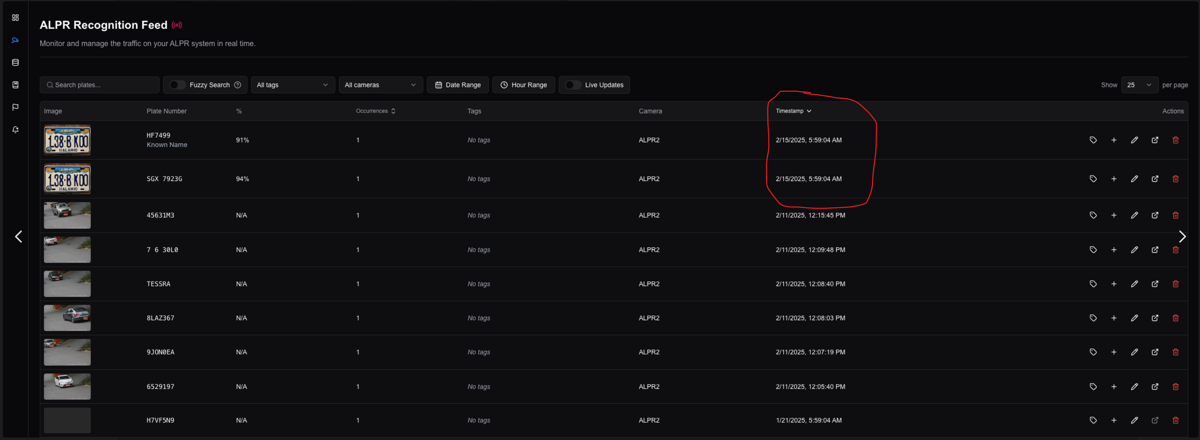

First part of ALPR training integration is done! Just need to set up the export processing and sharing now. Also adds the ability to do this which is cool (only laggy in the gif):
Sets the focal point as close as possible to the center of the plate for quick zoom in.
I'm also playing with some better use of layers in the UI:

Super excited about this feature. Is this to train a local model or is this a submission engine to provides images to train a common model that we would all use?
It would be a submission engine.
Could do both. You’ll be able to export your data if you want to test stuff yourself also, but the goal is to collect a huge diverse set of images and utilize the user input to improve the model for everyone.
