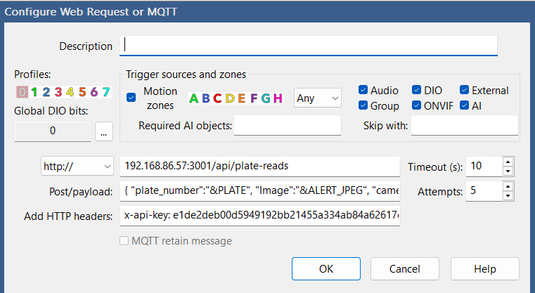

You fixed the missing x-api-key issue, but did you fix the missing "/api/plate-reads" in your ip address?
Good spot. @Vettester is right. I would use localhost instead of your hostname too if it’s the same machine just to prevent any issues.
Did you use the install script or did you create the directories and copy the files manually? Please check the logs tab at the bottom left of the app also and see if there are any other errors there. @sunny0101786
You fixed the missing x-api-key issue, but did you fix the missing "/api/plate-reads" in your ip address? It should be MY-PC:3000/api/plate-reads

Where did /dashboard/ come from? It should look exactly as it does in the example.
Let me just clarify the flow of how things work for this in case anything doesn't make sense
1) Your existing Blue Iris system uses either CodeProject or DeepStack and has an ALPR module installed. In this setup, the AI server (completely separate from this application) sends back the results from its detection to Blue Iris and BI saves it.
2) We use a Blue Iris alert action to then send that AI prediction to this application so that you can store and use them instead of just having it in the memo in Blue Iris. The &PLATE, &ALERT_JPEG, etc are Blue Iris "macros" which will replace that text with what the AI server sent.
3) This application is a combination of a web app and database that uses an API route to receive the data from Blue Iris and store it for you so you can actually use it.
4) Everything here is completely separate and is just a way to manage your ALPR recognitions.
So it goes ALPR camera stream -> Blue Iris sees motion and triggers -> AI server with ALPR module detects license plate -> Blue Iris gets the plate back from the AI -> Alert Action uses the & macros to get that data from the alert -> Web request sends data to the /api/plate-reads route of this app -> this app receives that data, processes it, then stores it in its database -> you can then access and manage the recognitions in your browser.
