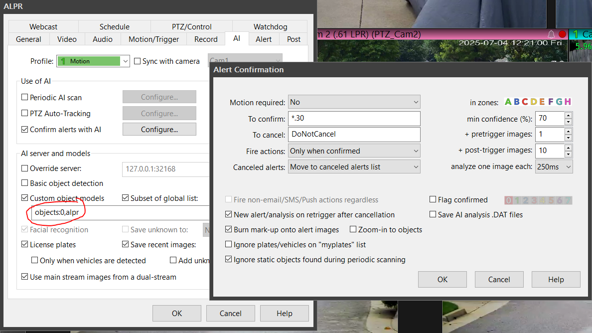

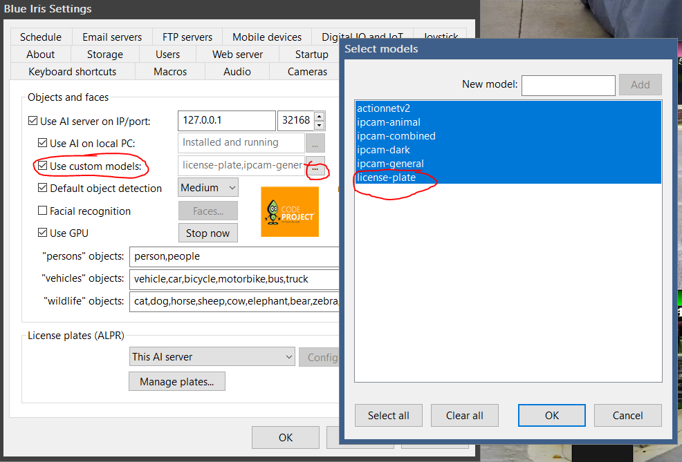

it appears that my issue is that i am unable to get BI to send the &PLATE out, it returns a blank entry
this is running on debian 12, i picked 5433 because years ago i had a testbed on 5432.
This might help.
