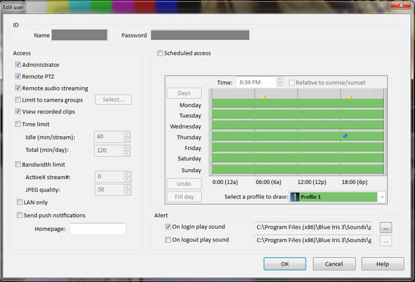

Disabling the hotkeys fixed the log in problem (and I see that you fixed in your latest update). The other problem still persists. In the sidebar I have the drop down set to all cameras and the camera button is set to not active. The top drop down only gives me one option "All Cameras" but it does not show all cameras, only the one that it opened with and which I have been unable to change. Here's a screen grab of my user account settings:
attachment.php
My setup is pretty simple. I don't have any schedules or profiles set and I don't have any limits set.

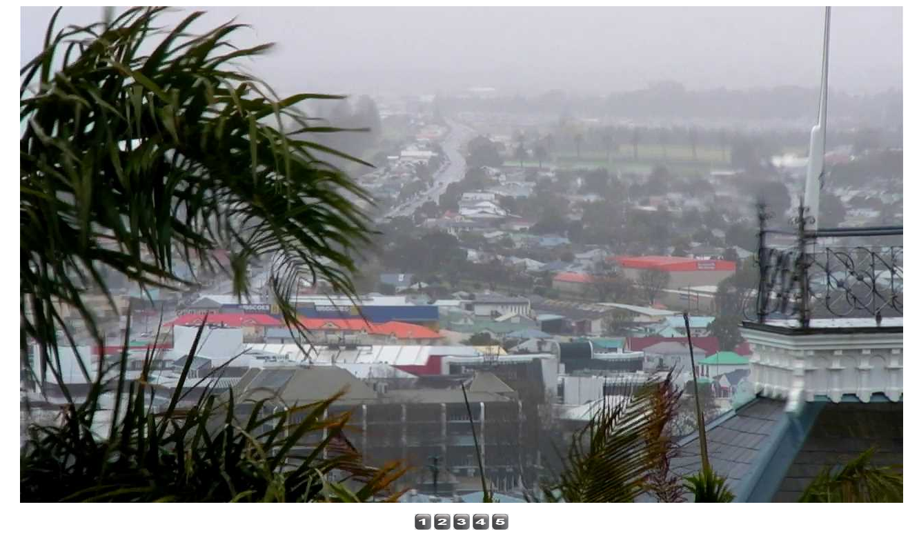

Here's a grab of what I have when I'm in UI2:
attachment.php
As you can see, the drop down at the top only has one option, "All cameras". The other one has the option for all five cameras and will show the clips from the selected cameras when you choose them, but will only show the clips from the camera that is in the main screen (GWC) when "all cameras" is selected there. Just to test something, I disabled GWC and selected hide disabled cameras and reloaded UI2 and it just jumped to the next available camera and displayed the exact same behavior. I get just "All cameras" in the top drop down box and when "All cameras" is selected in the side bar, I get only the clips from the camera that is in the main screen.
Some additional info: I had UI2 working fine previously (about a month ago) but after a month of experimenting (See this post.) I moved BI to a different Win 7 machine with a fresh install of Windows 7 and reinstalled BI (3.66) but imported the settings I had used previously.
Any ideas?
