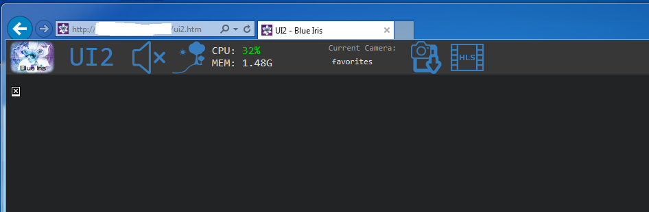

I just downloaded this and the jpegpull2.htm looks great! I tried opening the ui2.htm and for some reason it won't open completely. On the host it gets stuck at this point and doesn't load the page. I then tried it from another computer on my LAN and I get a message that says it's taking too long. Any thoughts? Thanks
For anyone else who may have this problem, the problem was that you can't just double-click the ui2.htm file; the page will open, but it won't be able to reach the Blue Iris server. You need to open it through Blue Iris's web server, as shown in the usage instructions in the first post. I will think about how I can make the page detect this condition and tell the user what is going on.

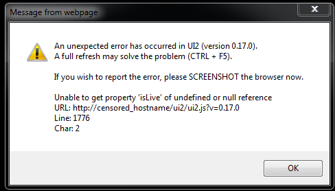

Hello, I Love UI2 interface. I use it on my iphone with the chrome browser and it worked great. I recently updated it to the .17 release and can no longer get it to work on my phone. I started getting the error attached. I have tried removing it and re adding it, Clearing caches and just about everything else. Any suggestions on what else I might try? And if not would it be possible to get another copy of the previous version? Thanks much.
I was getting this error on Safari - Installed v0.17.1 and now just get the attached

No video. Title bar only, since upgrading to 17.1
I'm thankful for the great UI that you have developed and am not complaining. I figure you are interested in the error though.
It does not happen on Chrome or Firefox. But it does happen on all of my machines on IE and Edge. If I can I'd like to use IE on my Win 7 machine because it is less impactfull on my CPU than Chrome and Firefox.
I just installed 17.1 and now the UI shows only the title bar. .
I was getting the error below in UI2 v 16.3 and in v 17.0. It was happening in IE 11.0.9600.18524 on Win 7 (V 6.1 Bld 7601 SP1. But not Chrome or Firefox.
Old error:
Unable to get property 'isLive' of undefined or null reference <url>ui2/ui2.js?v-0.17.0
line: 1776
Char: 2
