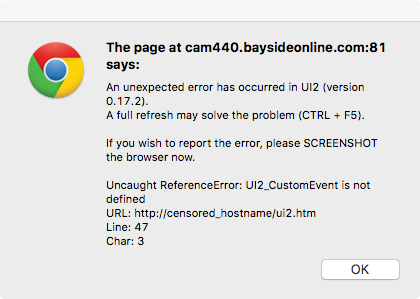

I threw this into my BI setup today to check it out, but got this error first, followed by a bunch of others. I could dig into the JS, but I figured I'd post here first.
EDIT: Never mind. I first tried to use it in IE, because I've been using the ActiveX control for BI. It works fine in Chrome :D

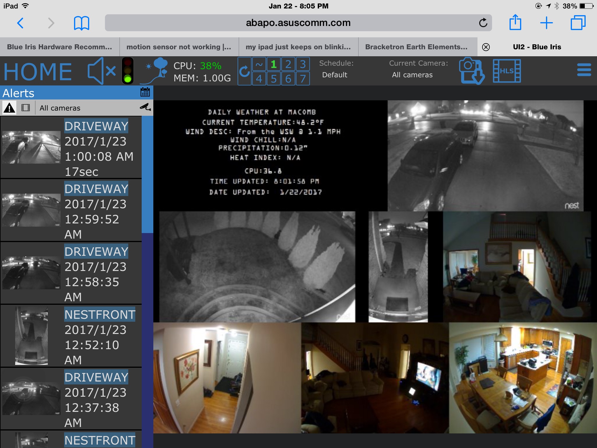

This may be a question for Blue Iris usage rather than the live view page. I recently switched to using portrait mode monitors at home. When I view the "all cams" view, the layout of cameras is undesirable with a ton of empty space above and below the view. The view shows the 12 cameras in a 4x3 grid. I'd prefer to have it as a 2x6 grid. I believe this may not be possible on the client side, as the server is generating this 4x3 image. Here's what it looks like.
Even in landscape mode, 4x3 is less desirable as it still results in wasted space above/below. I'd prefer 3x4 in the case of landscape mode monitor.
If this can't be altered with the live view, anyone know if it can be altered within Blue Iris?
You can adjust the resolution of the group views Blue Iris sends out, and keep tweaking until BI lays out the cameras the way you want them and with a minimum of empty black space. For the best results, keep the dimensions to multiples of 16.
