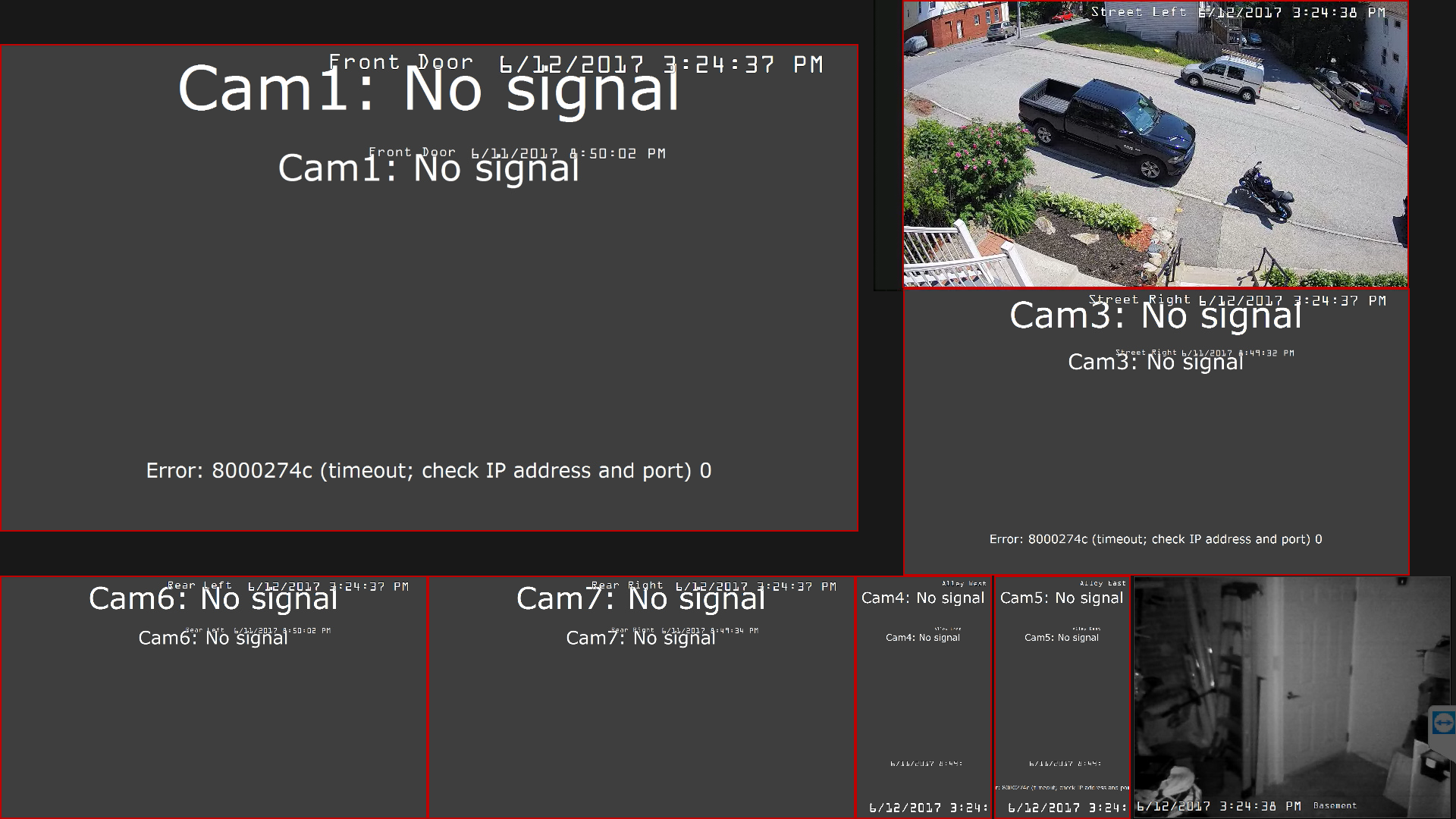

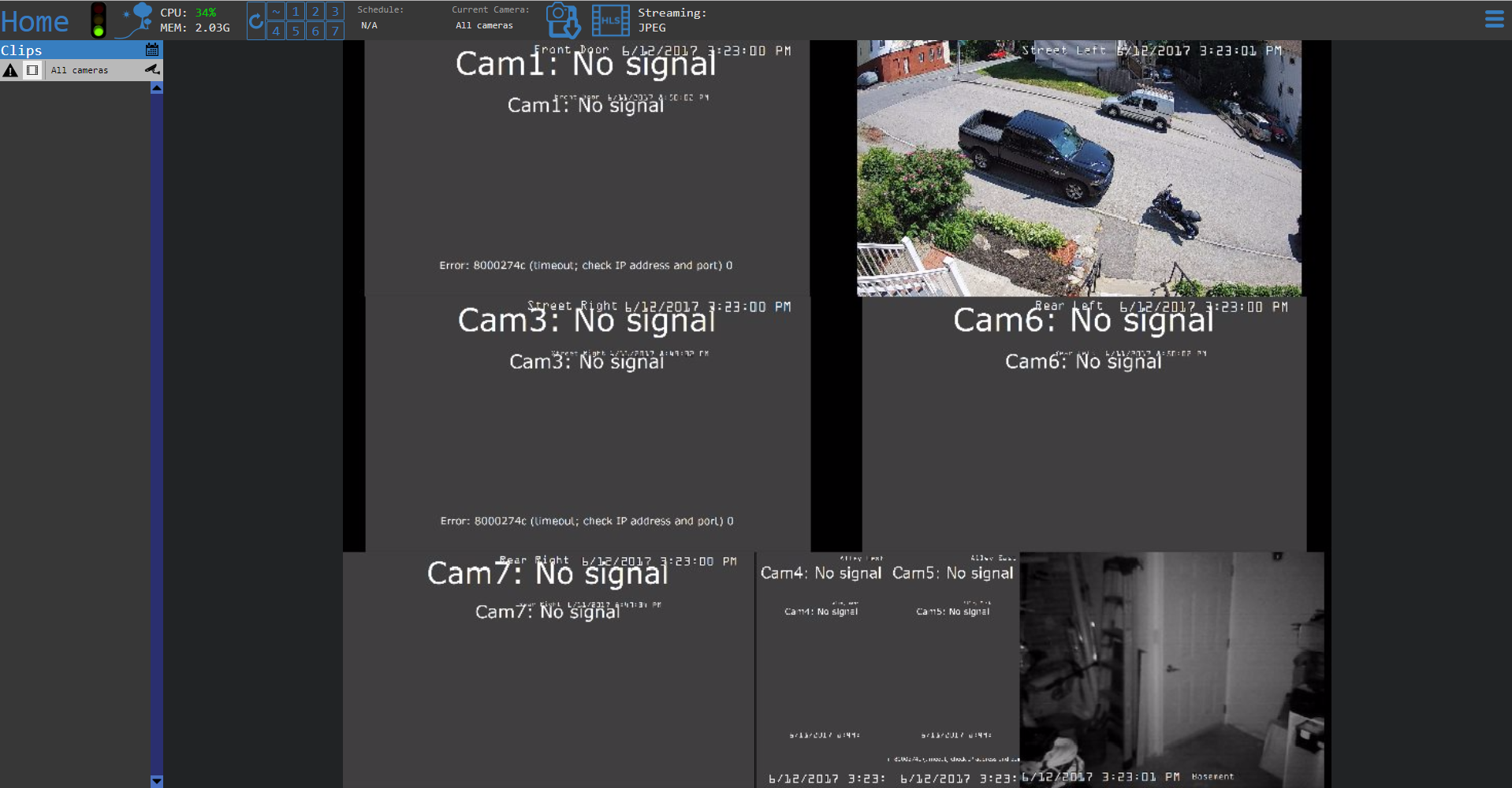

Is there any way to adjust the aspect of the camera window? I have my system running at 1080p so it's 16:9, it looks like UI2 wants to smoosh all the cameras in a 4:3 format. That results in all the cameras being on top of each other, skewed, etc..
The UI is excellent and working great otherwise!

Ah. The cameras aren't overlapping and they aren't skewed, but the group image resolution isn't a good fit for your browser.
You can adjust the group image resolution here in Blue Iris:
Blue Iris tries to fit your cameras as well as possible into the frame size you specify, while preserving aspect ratios and keeping the same order of cameras.
For best results you want the numbers in the resolution to be multiples of 16. So for example based on your UI2 screenshot, this might be a good fit: 1712 x 944. You don't want the frame size to be too big because the bigger it is, the lower your frame rate will be in the web interface.
You can adjust the width and height individually to tweak how the cameras are laid out, and to affect how much black space there may be around and between cameras.
Here is a list of multiples of 16 to help you out in dialing in the ideal frame size for your All cameras group:
16, 32, 48, 64, 80, 96, 112, 128, 144, 160, 176, 192, 208, 224, 240, 256, 272, 288, 304, 320, 336, 352, 368, 384, 400, 416, 432, 448, 464, 480, 496, 512, 528, 544, 560, 576, 592, 608, 624, 640, 656, 672, 688, 704, 720, 736, 752, 768, 784, 800, 816, 832, 848, 864, 880, 896, 912, 928, 944, 960, 976, 992, 1008, 1024, 1040, 1056, 1072, 1088, 1104, 1120, 1136, 1152, 1168, 1184, 1200, 1216, 1232, 1248, 1264, 1280, 1296, 1312, 1328, 1344, 1360, 1376, 1392, 1408, 1424, 1440, 1456, 1472, 1488, 1504, 1520, 1536, 1552, 1568, 1584, 1600, 1616, 1632, 1648, 1664, 1680, 1696, 1712, 1728, 1744, 1760, 1776, 1792, 1808, 1824, 1840, 1856, 1872, 1888, 1904, 1920, 1936, 1952, 1968, 1984, 2000, 2016, 2032, 2048, 2064, 2080, 2096, 2112, 2128, 2144, 2160, 2176, 2192, 2208, 2224, 2240, 2256, 2272, 2288, 2304, 2320, 2336, 2352, 2368, 2384, 2400

Thank you, It's still very different from the BI display, but I will play with it and tweak it. I have a few cameras that don't match the rest. Most are 1080p cameras, but I have 2 of them rotated sideways and 1 of my cameras is a 640x480. So they don't tile all that great. I wish BI would allow free movement of the cameras in the group.
Yes, there is no denying it would be quite useful to have free movement of the cameras. But it would be a relatively complicated system all of its own, to configure it.
I think your biggest problem here is that you've set up one camera to be larger than the others, but Blue Iris doesn't pay any attention to this when setting up a group view for a mobile app or web interface. As long as you use a "1:1" layout, it is usually possible to reproduce the same layout by choosing a similar frame size to what you have in your local GUI.
Reactions: looney2ns
I set up a 1:1 layout but my camera compliment didn't lend it self to that very well. I ended up making my web group super wide. Doesn't match my layout in BI but it looks nice and fills the area well.
Yeah, it gets easier when you have more cameras and are willing to rearrange them somewhat to ensure the layout is clean. Corridor/rotated cameras have a pretty significant effect on the layout too since they take up a very odd amount of space.
