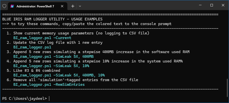

USAGE GUIDE Screenshots:
SCRIPT ZIP FILE:
Advanced features...
The script also has two optional commands that can insert and remove fake data to simulate a memory leak event.
Why? This can be useful when testing scripts that monitor the CSV log file.
For example:
BI_ram_logger.ps1 -SimLeak 5X, 400MB will append 5 new rows simulating a stepwise 400MB increase in the software used RAM column.
BI_ram_logger.ps1 -RemSimEntries will remove all 'simulation'-tagged entries from the CSV log file.
To learn more, try
bi_ram_logger -Examples
