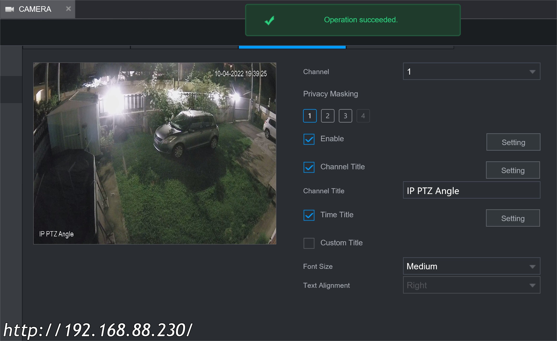

Hi Cor
i have same model SD2244T-GN but cannot configure privacy masking.
once configured, when i save, the mask disappear, even web or console (system version is V4.001.0000003.2, Build Date: 10-10-2020 )
can you tell me how you can do that?
thanks
swko
Hi Cor
thanks
swko
Are you using Windows Internet Explorer or some other browser to access the cameras settings? You need to use Windows Internet Explorer (not Edge).
Hi
I use chrome.
bu just try with IE11, and have same problem:
as shown on picture, when configured, you can see the mask square, but once applied, the mask disappear.
PS: for Fixed cam, the mask is working. I have this problem only with SD2244T-GN PTZ while 24 privacy masking are available by spec of this model...
any idea welcome.
swko

Hi
I've resolved the problem, some restrictions for dahua PTZ cam:
  • use IE 11 only
  • download NACL as expected.
  • connect directly to IP CAM to configure privacy masking,
  • DON'T configure privacy masking through NVR, change will not saved
swko
