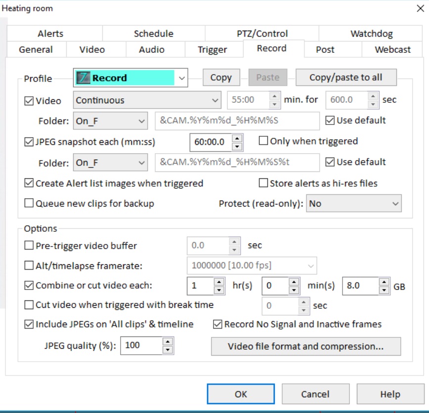

On the camera which just needs to record twice a day and for about half an hour , and than on motion trigger, I made an extra profile (7- Record, the other profiles are set to motion detect) , and made a schedule for that with overiding everything. That worked. Only thing is , it is recording from xx:55 untill xx:25, it show in the android app as 2 different videos cuts it exactly on the hour, any idea how I set it , that is is recorded as 1 video?
All my other cameras are set at "cut every hour" , see attachment 3. I think there might be the issue.

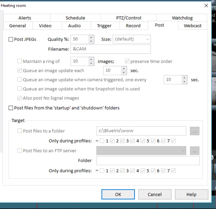

The other camera, which needs to make a snapshot every hour, not so succesfull. You said to use the post function , but how do I set there the time when the snapshot should happen? I want a snapshot every xx:05.
I just tried to make every hour a small video, so I made 24 schedules of 1 minute. This probably works as well. ( see attachment 1 and 2)

You need to increase the combine and cut length if you want it to be one clip.
You dont need to use the post function at all. Just set snapshots up in the record tab.
Reactions: anijet
@fenderman : Thanks!
I have now set the cut-combine to 1,5 hours...
When I set the snapshots , , where do I set the time it has to take a snapshot? , I would like a snapshot every 1 hour , at 5 past the hour , so 12:05 . 13:05 etc. Is that possible?
