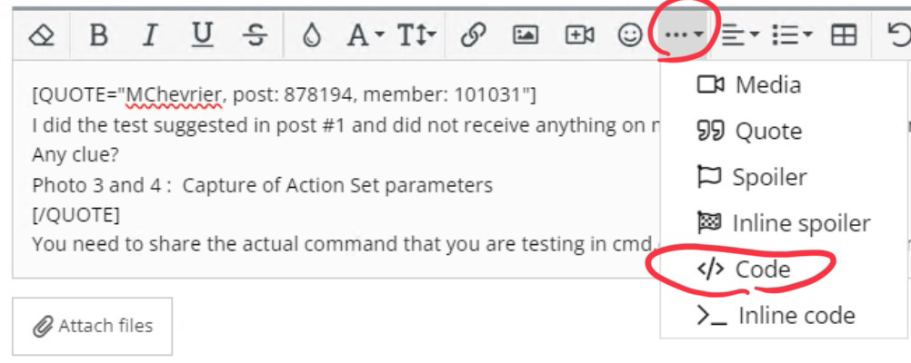

You need to share the actual command that you are testing in cmd.exe. Not a screen grab of cmd.exe, but the actual command text, preferably in a code block.
