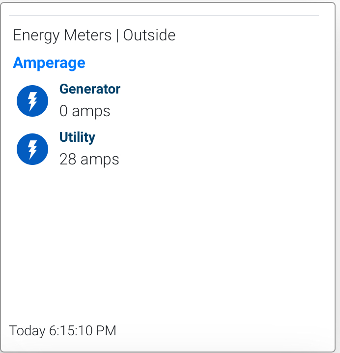

I would like to overlay some information from HomeSeer, specifically device values plus text.
Here is the output from HomeSeer:
If the above can be saved as a text file then BI can display it as an overlay. Below is from @Mike back on Dec. 2, 2016:

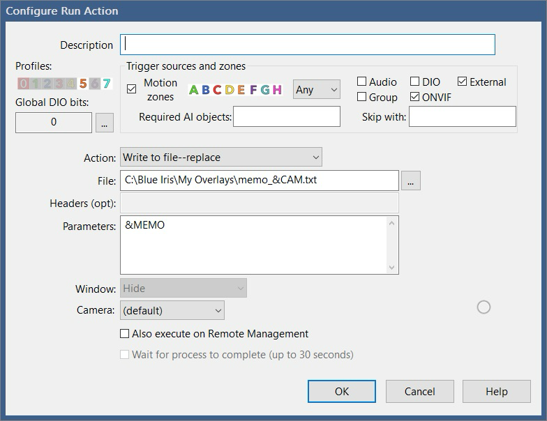

Hi @JNDATHP , I am trying to find an example of &MEMO macro. My use case is that I want to add text to the alert image title when triggered. Exactly what Codeproject ALPR does when detects the plate. I looked everywhere and could not find a functional solution. I did look through BI manual and it lists '&MEMO' macro, but I am not sure how to apply it in my case. I think it may work. Can you help with this? Thanks.
If I understand the question correctly, my solution would be to add a ‘Write to a file’ action to the ‘On alert’ Action set like the screenshot below.
Then I’d assign that file to a Blue Iris macro, like %301, and add that macro as an overlay.

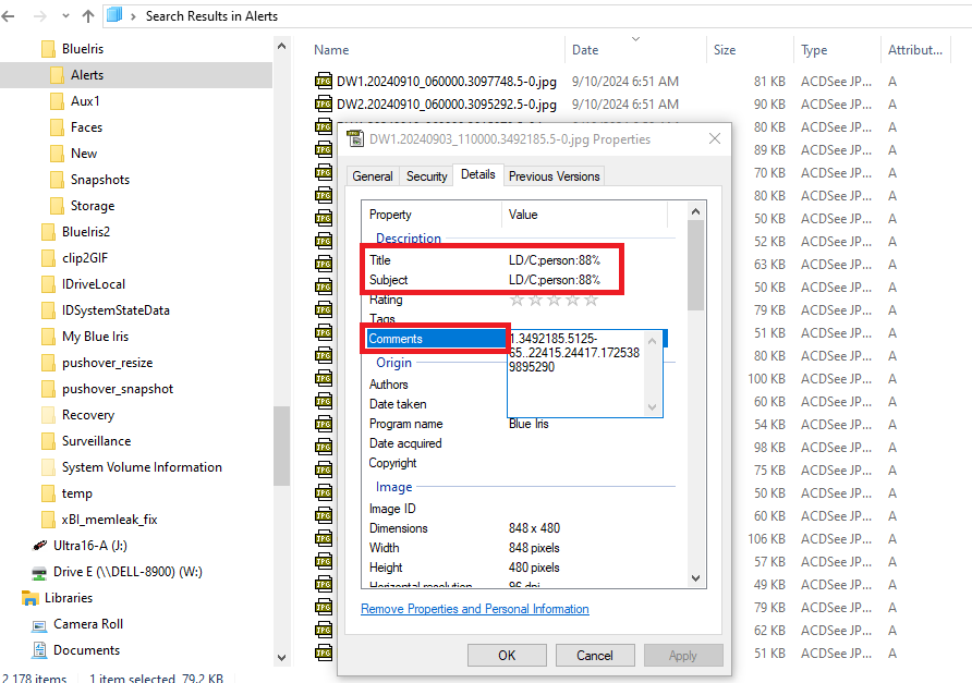

It just dawned on me that you might not be aware that Blue Iris automatically stores the AI memo and license tag info in the Alert JPG's Exif metadata.
Reminder: to create Alert JPGs, you must configure the camera to save Hi-Res JPGs, or enable AI image markups.
To easily inspect the Exif data In Windows File Explorer, right-click the JPG file, then click Properties > Details tab
The AI memo string (= &MEMO macro) is stored in the Exif 'Title' and 'Subject' tags.
Ken replied with the following when I asked for an explanation of what is in the 'Comments' tag...
(Caveat: this was October 2023... it's always possible that he has changed something since then)
PropertyTagExifUserComment
1 ... the version of this code ... should be 1
1366323 ... the time offset into the clip
6149 .. the "high order" of flags (bits 16-31 shifted left 16)
65 ... the zones
plate ... (LPR plate would go here optionally)
23195 ... the trigger duration (msec)
28236 ... this time includes the pre-trigger time for playback
BTW, I don't use LPR, so I cannot confirm that the license plate info is actually included in the 'Comments' tag.
[EDIT} Blue Iris uses this Exif metadata in Alert folder JPG files to recover alert database entries during database rebuilds. I use this feature as the basis for my bi_alert_protect.ps1 utility.

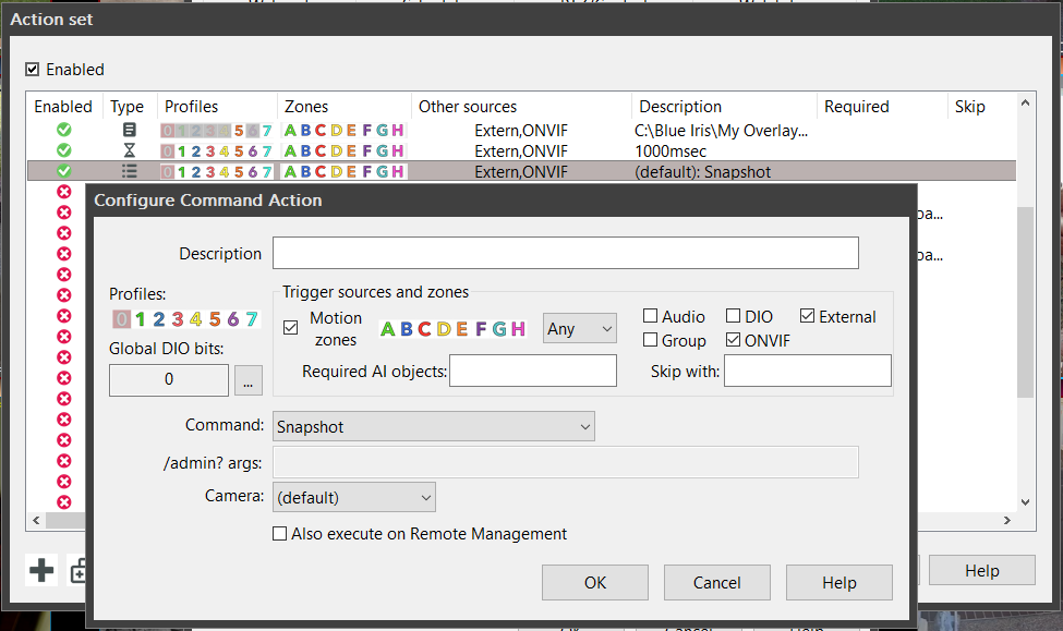

BTW, here's a method for creating a JPG with the memo overlay...
1. Add a new 'Do command' action to the 'On alert' action set to take a snapshot (see screenshot). KEY POINT: it must follow the 'Write to a file' action.
2. Maybe precede it with a 'Wait' action if necessary. EDIT: I just tested this and it worked without a 'Wait' action
If you do this, you will definitely need to programmatically add the Exif 'Title' and 'Subject' tags.
Also, keep in mind that Blue Iris creates snapshots in the 'New' folder, not the 'Alerts' folder.

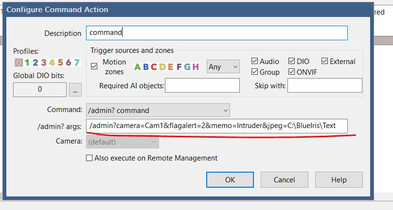

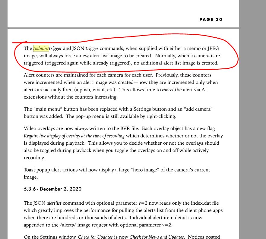

I tried the use of /admin?camera command, but again fruitlessly. I am thinking of a different approach. The best would be to use code project AI OCR module, but I don't think BI has this capability or will integrate. What I am looking for at the end is to be able to dynamically assign labels to jpgs. This is needed for my specific use case where I can later use the 'search box' in BI interface to look for the text in the memo which will get me straight to the event. Say on trigger camera records part number 'A-1234' and adds it as a label(memo) to the alert jpg image. The function of BI that does it flawlessly is the ALPR, but it won't read regular text. I have displays at the facility displaying the part number codes. I integrated the scanner to send API to the camera with the scanned part code and now need to make this same code added to the jpg trigger image. The other option as i mentioned above is to have camera read the code off of the display and add it after OCR processing to saved JPG.
Not sure if all that I am going after here is even possible so I might have to find a different solution.

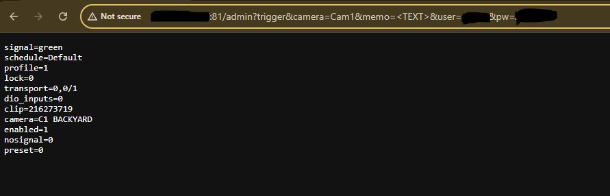

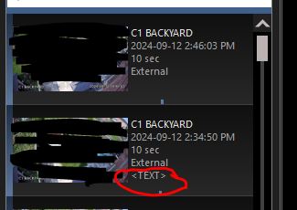

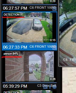

Good afternoon All,
I am happy to report that after testing a few approaches I finally got it to do what I want! @jaydeel , big thanks for pointing me in the right direction with your 'snapshot' option. I did not use it, but it opened up another path for me. So I read the manual and found '/admin?trigger' option which I experimented with and got it to work. Below is the string yo need to use in order to 'bake' a memo to an alert image which can be searched later if typed into the search box. I experimented with the web browser window, but the options are limitless it is now can be made into a script, etc.
http://<server's IP>:<port>/admin?trigger&camera=<CAMERA SHORT NAME>&memo=<TEXT>&user=<USER>&pw=<PASSWORD>
Hope this helps others who are looking to inject a memo text to an alert image. And thanks for everyone's help with htis.
Reactions: jaydeel
Good afternoon All,
attached is snapshot of the correct output to look for if the command went in successfully and during the test.
