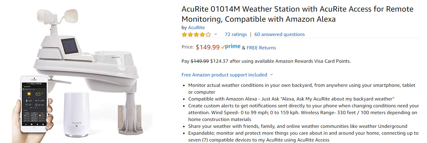

I don't have a weather station, but if there was a low end model that could do temp, wind, humidity I'd consider putting one up just so Blue Iris had accurate and timely updates. WUnderground has been hit of miss with me, with certain "stations" going offline and having to switch to others.
I was looking at them a year or so ago online..
Shop Amazon.com | Weather Stations
As an Amazon Associate IPCamTalk earns from qualifying purchases.
I have this one - Accurite 5 in 1. It comes with different options, but I did not need or want their 'desktop' display unit. I bought it with their 'hub' which can upload the data to Weather Underground and you can also view the data on any computer or laptop with a webpage. The hub connects wirelessly to the 5 in 1 and then to your network via an ethernet cable. (My hub is on the ground floor and the 5 in 1 is on top of the chimney of a 2 story house). You can spend a lot more money, but I have been pretty happy with this one. I first got started with My Accurite because I bought one of their thermometers that had 3 wireless sensors that I could place around the house and I was also able to use them with their hub
