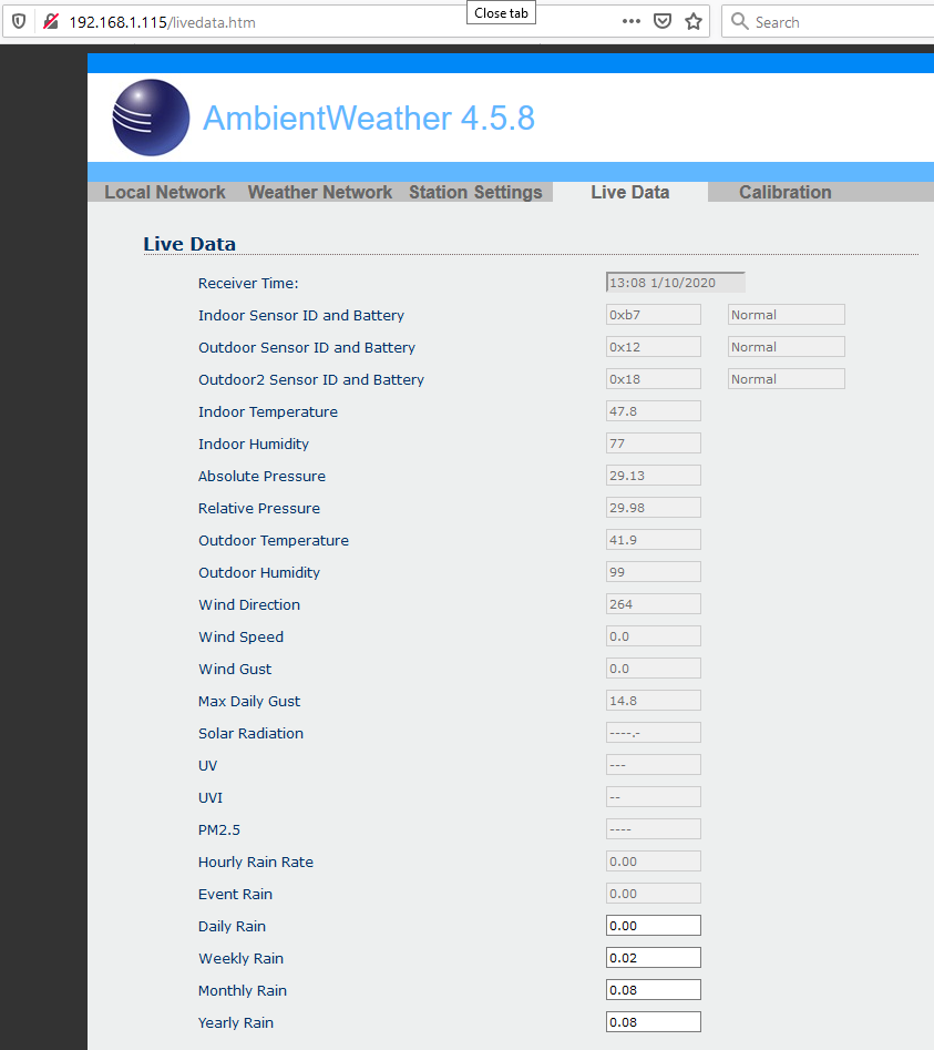

FWIW, here's the local page for ObserverIP for my Ambient Weather brand weather station.

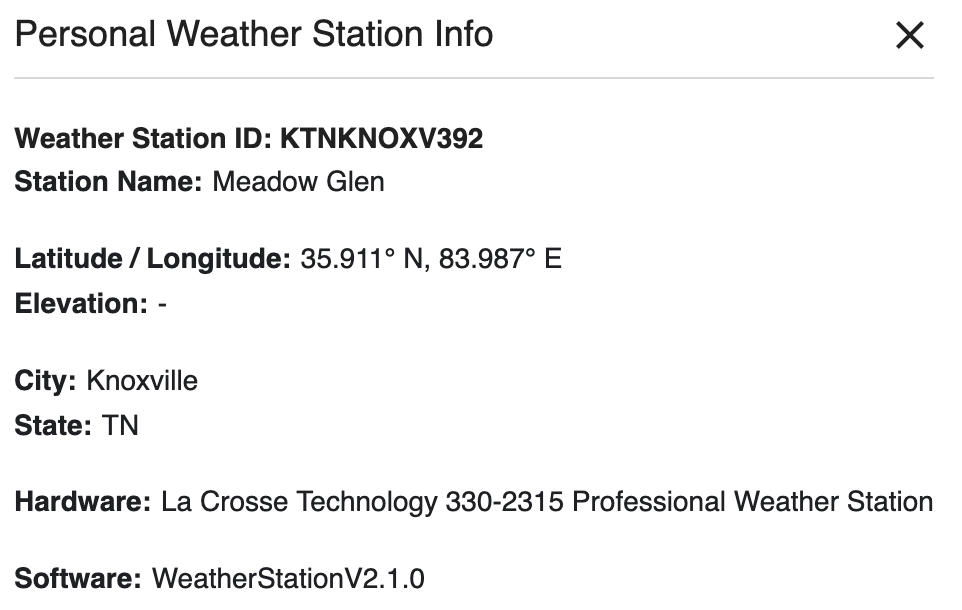

Hi Mike, I appreciate you looking into solutions for those of us who have their own PWS and would like to continue to use that data in BIT for our overlays. Here's my PWS info and I'd be happy to help test for you.
